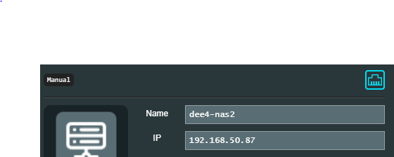

Here is an example of a forwarded port
But I'm having trouble getting a TCP connection check:

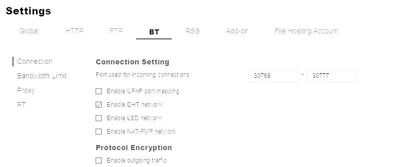

Here is the Bittorrent client on my NAS (not sure what's up with picture quality)
The results are the same whether I have port forwarding set up for the above range or not.
