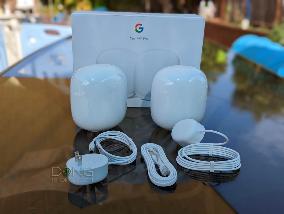

Dongs review is one of many that I read. Lot of good reviews too which is why I asked for some real world use input. Maybe Viktor will jump in here when he sees his mention. Was also aware of the phone app setup but it’s a household that already uses the Home app for some other google devices.
