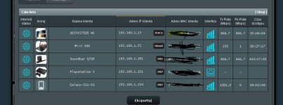

using dropbear ssh ???
Doesn't look like anyone is connected?
connected
and now
