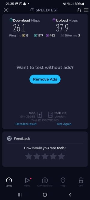

So im not sure whats happening qos is off wired i have 958 up and down but when i speed test phones s21 ultra iphone 15 and 16 im only geting 24 to 54mbs

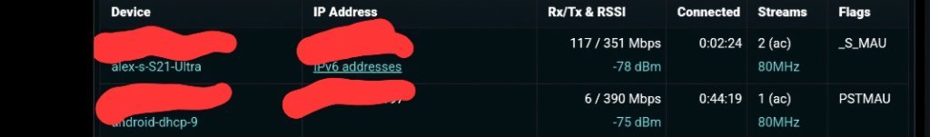

Neither are we, based on your description. What WiFi band is being used by the phones during the tests? What connection rate in Wireless Log page for each device?

-75 and -78 dB is very marginal signal power. You really want more than -67 dB (smaller number e.g. -55)
. So likely susceptible to interference from other radios

I have a b88u plugged in outside in a log cabin connected via ethernet would that be the issue as that seems to have same issue its only allowing 23mbps to 34
could be walls and/or interference more likely. Also could be your wifi client is having issues itself.

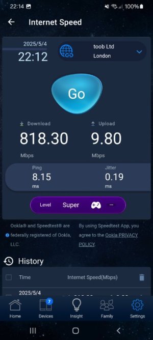

Its like if i run internet test from the be88u

What is upload supposed to be? 958 Mbit also? Something is wrong if so. Double check if any type of QoS is active.
Both routers has qos of and yes 958 up and down normaly when im looking at netspot wifi analysis be88u wifi are 44dbm but the gt ax11000 is 72 88 etc its also failing get above 600 somtikes 728mbps
