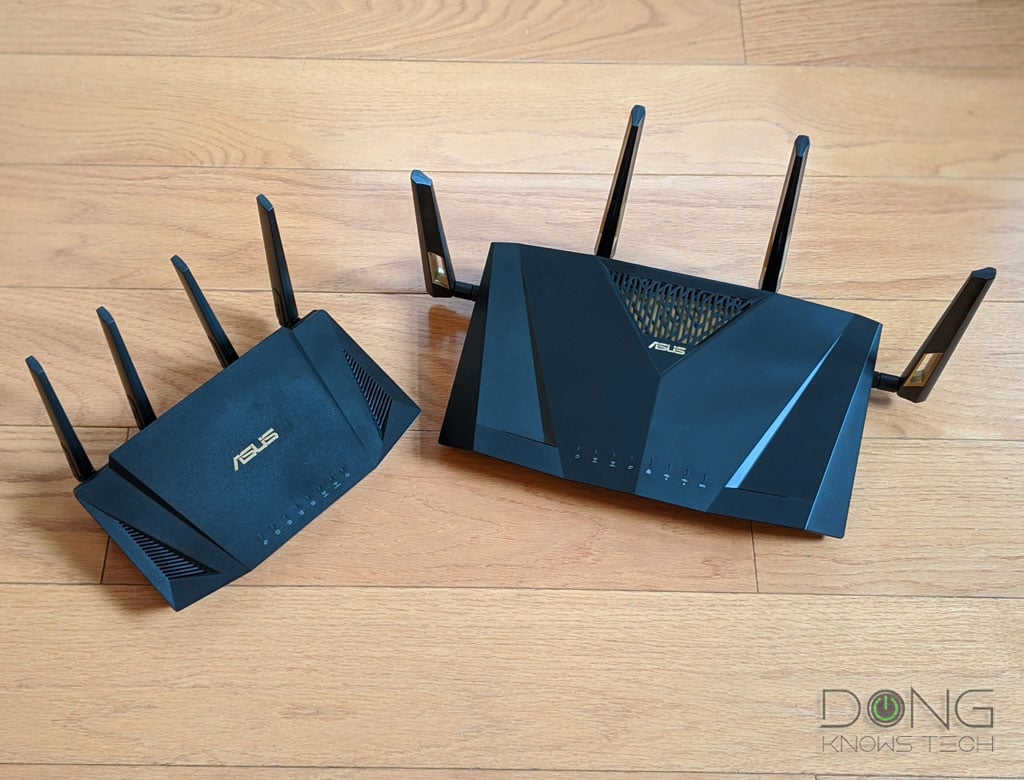

Theres a few cheaper triband options i.e. RT-AX92U however If it's wired you sld be gtg with dual-band but check out this article explaining the best options:
@Kingp1n Thanks for the link to Dong's article. He has good reviews.
I read "This list is sorted in the order of my experience, newest on top —
the order is not meant to be the ranking.", yet my trusty AC86 is #1 ;)
