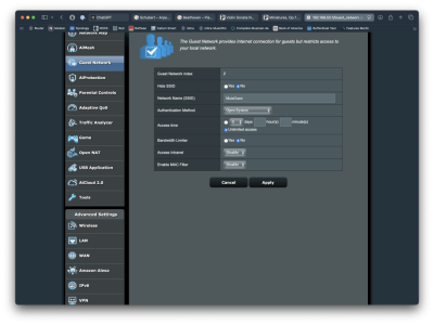

See attached screen shot of guest network settings. Global bandwidth limiter is on, but not on guest network specifically.

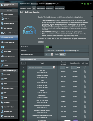

Why do I use bandwidth limiter? Because Cake limits the bandwidth to ~350Mbps (and I get gigabit speeds due to a screwup at Xfinity!). And I do certain things that require very low latency (not gaming) and I don't want other devices to start some massive download that'll blow up the router queue.
Attached is the limiter settings.
