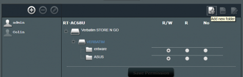

You must create shared folders through the router's GUI.
AsusUsurper
Yep. Did all that - would not work as I could not adjust the permissions (effectively greyed out). However, I did discover that if I turned off 'Guest Access' and created a bunch of dummy accounts, I could then set the permissions of those accounts, and the 'root account' (which I could not set before - not that weird since with 'guest access on, there really is no 'root account' - problem is there's now way to set guest permissions), and now it seems to be working (and the disk size now shows as ~60Gb) Need to test if I can turn guess access back on to see if it works).
