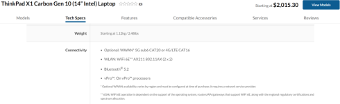

Is the client device with the AX210 card running Windows 11? If not, I don't believe 6E (i.e. 6GHz) will be supported.

Afaik, Windows 10 isn't supported (and ordering an AX211 part from any manufacturer with Windows 10 isn't possible).
How to Enable Wi-Fi 6E/ 6GHz Band Using Intel® Wi-Fi 6E (Gig+)...
I would not be relying on the RT-AX88U to act (even/only) as a switch.
Buy an 8 Port or better switch for $50 instead for a more reliable network.
