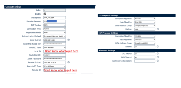

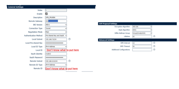

On the NR300 i used the next configuration:
Try authentication with just psk and no xauth?
without PSK the router Asus show this:

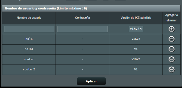

Sorry, I'm just shooting in the dark: I don't see any users listed in your config.
I have 4 users, router and router 2 users are for the NR300, i tried with V1 and V1 & V2.
