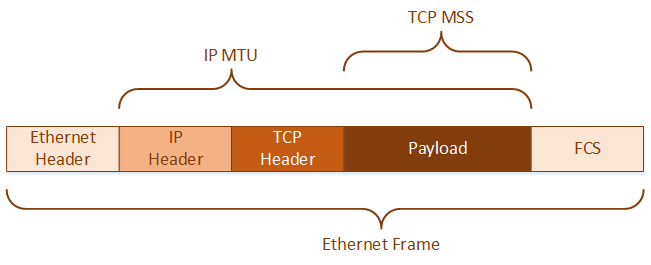

I need to set my MSS to a specific value. I know it can be set through iptables, but I also know that I don't know enough to mess with it. Any help will be appreciated.
MSS is derived from MTU + header size - which depends on protcol (e.g. IPv4 vs IPv6 etc.)
Not sure why you would want to set MSS instead of MTU
