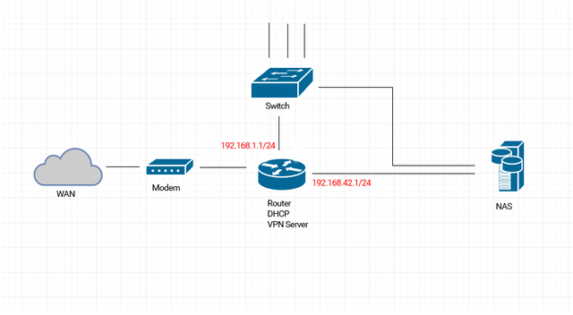

I'm a networking novice looking to setup a VPN that allows me to securely access my local NAS over the WAN. I already have this running using PPTP. The router acts as the VPN server. As it is now, this provides the VPN client (Windows & Linux laptops) unrestricted access to my entire LAN. I want to limit this so VPN clients have access to nothing but the NAS. What is the most robust/secure way to do this?
I'm thinking of creating two VLANs. Most of my LAN would run on VLAN1, but one RJ45 port on the router connected to the NAS would run on VLAN2. Looking at the OpenVPN configuration on my router, it looks like I could then switch from TUN to TAP and then bridge the OpenVPN server to VLAN2. I think that would achieve my goal

VLAN's live in the ethernet layer of the stack... that's why in even a simple L2-Managed switch, we can define VLAN's without having any layer 3 management activity on it.
VPN's can live at that layer as well - for example with L2TP/IPSec, or they can encapsulate ethernet frames at the IP layer like OpenVPN - with OVPN, we push frames into the IP layer, mush them over the Public WAN, and on the other end, we take them back out.
As to your question about VPN and access to resources, not limited to VLAN's, this is routing, which is different than switching... VLAN's and VPN's - both can be routed, as the VPN will present an interface and a virtual MAC address - and through routing, we can make decisions regarding policy - what data goes where, and this is generally done at a generic description of access control.
There's lots of ways to do things - but generally in network design, it's best to keep things as simple as possible - introducing new elements on an as needed basis only if the need is justified.
Okay, routing, not switching! Thank you! I've done some googling and stumbled across concepts like access control lists and firewall rules, which appear more applicable to my problem than VLANs.
Given this:
VLAN1 local subnet 1 192.168.1.x/24
VLAN2 local subnet 2 192.168.42.x/24
VPN non-local subnet 172.168.1.x/24
VPN clients are dynamically assigned IP addresses from the non-local subnet's IP range. If I intend to restrict VPN client access to VLAN2, then I would setup rules that prevent routing between 172.168.1.x and 192.168.1.x but allow routing to 192.168.42.x. Correct?
Is the ability to define such routing rules the main reason why remote access VPN clients are typically manged in their own subnet, or is there some other more important reason behind that which I haven't yet understood?
