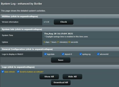

I had at one time Unbound showing up as Scribe system log but i did something and it disappeared. I wasn't getting any data in the Unbound log so i was messing with it now its gone, the log that it. Everything else works. RT-AX86U PRO using firmware version: 3006.102.5.0
I have the following and running correctly:
Unbound
Skynet
Diversion
Scribe
MerlinAU

There is supposed to be a menu option in Unbound Manager to enable scribe logging.
maybe there was when i installed it, but i don't see the Scribe Unbound Manager Logging option any longer in Unbound Manager. Anything I can do short of reinstalling unbound manager to get back the Scribe Unbound Log? I already reinstalled Scribe and Scribe UI but didn't work.
