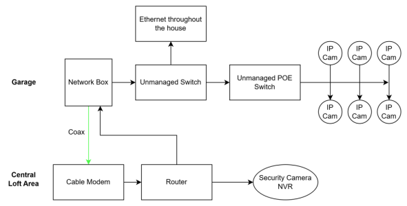

Well it's not an ideal setup due to the garage having the network panel. The garage is on the far end of the house and I have a wifi router located in a good central location in the house. So the modem and wifi router are in the center of the house > cat 5 line to garage panel > switch in garage panel, and then it goes to the rest of the house. So I think I would benefit from getting the camera traffic off of it? I believe this means that currently all cam traffic goes through cat 5 to my router and then to my NVR. Yeah I could go with a more complicated setup with access points but the wifi router hits everywhere I need it to. If I can fix this with a MoCA on a dedicated coax line from NVR to PoE camera switch then that seems good?
I can't suggest anything at this point. Draw a network diagram.
Current:
First diagram - only WAN-LAN traffic may be affected if >800Mbps.
Second diagram is better, but with additional MoCA expense. VLAN separated camera network is best.
According to first diagram only WAN-LAN traffic may be affected if >800Mbps.
Do you mean it's best to separate the cam network with a vlan from a network security perspective? I would still need the MoCA to separate the traffic to not limit a >800 mbps connection right?

If you have the RG6 already in place, just grab a pair of MOCA 2.5 modems and install as shown in your diagram. If you have other cameras, you will have to set up same for them or resort to VLANs and change out some of the gear if the switches don't support assigning VLAN to ports (layer 2.5 or layer2+ ) and replace the router with a SMB router that has built in VLAN support. Alternatively, you could just add a layer 3 managed switch instead of replacing the router and replace any switch that doesn't support VLANs at least at layer 2.5/2+
Long term you want to either commit to physical isolation of camera system or VLAN based hardware.
