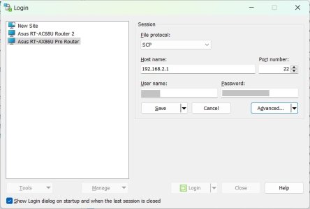

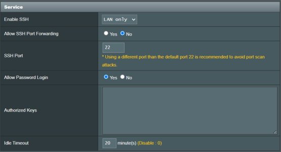

Not having any issues using WinSCP to access either a RT-AX86U Pro or a RT-AC68U (both running Asus-Merlin firmware) from the local network side. Check the configuration (like IP address, port # and SCP setting) for both to ensure they match. Examples attached.
