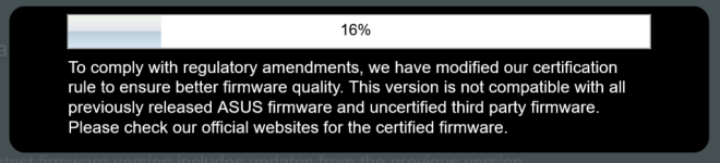

I am running Asus Merlin 386.7_beta2 and I downloaded 386.7_2 to upgrade.
However, the upgrade failed and reloaded the beta2 version.
How should I proceed?
Different message. This one didn`t say that flashing failed, it says that the firmware failed validation before beginning the flash.No, I've seen that message too when trying to flash the correct firmware to the matched router.
I have checked the download several times. It is from the same Merlin download directory as previous successful firmware upgrades. I've re-downloaded it several times... always the same file details (the hash matches the one listed at https://www.asuswrt-merlin.net/download).Different message. This one didn`t say that flashing failed, it says that the firmware failed validation before beginning the flash.
