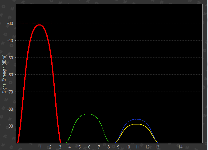

I have a Dell Studio XPS 16 with Intel WiFi Link 5300AGN card in it using driver 13.1.1.1(from 13-1-2010). Windows 7 x64 Ultimate shows me a link rate of 300Mbps, all this and following is when being in the same room as the router and at 2-3 meter distance. I have the WNDR3700 speed mode set to "up to 300mbps" and it is using WPA2-PSK(AES) for security. WMM settings for both bands are enabled. I only have N clients and when testing there was only one wireless client connected being the Studio XPS, the other client being a PC (with raid0 Samsung F1) connected at 1gbps via LAN. There are only a couple wireless networks in the area (more then 15 meters distance) and I am not using the same channel as them. (see image here)

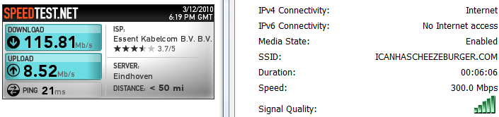

But it doesn't seem to be able to get past the 47Mbps, when I use speedtest.net the meter bounces off that invisible wall repeatedly. (Note: I have 120Mbps/10Mbps cable and tested the connection prior and after the wireless tests using the wired PC with no problems and steady 117/9.7mbps)

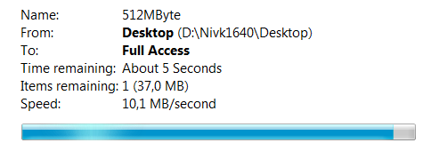

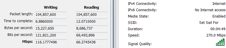

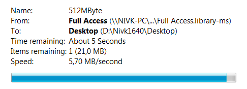

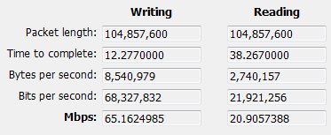

Even when using a homegroup transfer I have this problem, but when I upload from the laptop to the PC I get almost double that speed: 11MBps. I had not noticed this wireless downlink wall before but since I bought an extra TL-WR1043ND to use as cheap Gigabit switch with added wireless coverage bonus, when I did some tests on it with that same Dell Studio XPS same range (2-3 meter) this got me thinking its not the laptop but perhaps the WNDR3700 is not working as it should? (The TP-Link has DHCP turned off perhaps this improves its performance nonetheless it's downlink speed is almost triple that of the WNDR3700? click for Lan Speedtest between wireless XPS connected with TP-Link and wired PC)

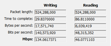

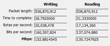

Set the TP-Link to be the DHCP server and turned it off on the WNDR3700, also turned off its SPI Firewall and made sure guests networks are disabled. Then I tested each radio (2,4GHz or 5GHz) again while the other radio was turned off. I am certain both computers have a read/write faster then 400mbps so they are not limiting speed. The laptop was booted into safe mode and from there I started the Lan Speed test, the 5GHz is able to reach 130/150 mbps (down/up). But the 2,4GHz downlink is still "stuck" 46/134 mbps (down/up). I said earlier that when I set the speed mode to "up to 130 mbps" it will also limit at 47mbps downlink, but I was wrong actually (blame nocturnal testing). If I set it to up to 130mbps it will actually only get a downlink speed of about 21mbps..

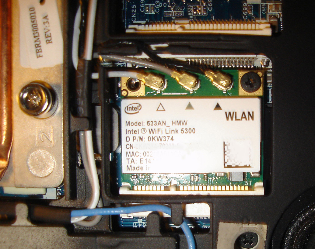

Did you install the 5300 cards yourself or were they factory installed? If you installed, maybe antenna connections are wrong? Two antennas should be connected to terminals 1 and 2. BTW, I'm separating this into its own thread to make it easier for others to find.
Yes the 5300 cards are factory installed by Dell. I have one XPS M1530, in this one I installed a 5300 card myself. But have not tested with that laptop yet, certain though I did it correct, because I tested it after I installed it about 4 months ago with the WNDR3700 actually...:confused:

Also made sure the wires of the 5300 card are attached properly. I borrowed a WUSB600N (think it is a version 1) and did some tests with it, strangely enough its downlink is better at about 66Mbps.

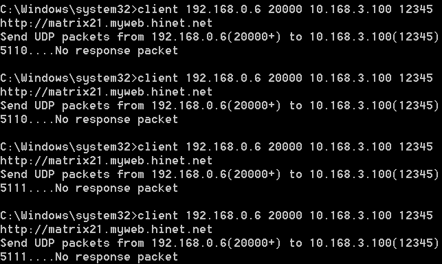

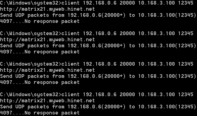

Since I was testing it anyway I also tested its maximum concurrent sessions with the Matrix21 Router Session Test Tool. My WNDR3700 maxed at 4096 concurrent sessions(power cycled before each test) which is about the same as the DIR-825. I also tested my TP-LINK TL-WR1043ND and it maxed out at 5109.
