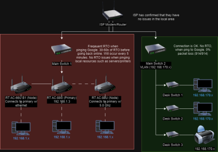

Good day, this is my first time posting so I hope I've posted this in the right thread. My office currently has an AiMesh setup consisting of an RT-AC88U as the primary router, as well as another RT-AC88U and an RT-AC66U B1 as nodes. Previously, we had no major issues when connecting to the internet, however since last week lately we seem to have encountered intermittent connection issues when accessing the internet. For better understanding, I have also attached a network diagram of our office. I hope its acceptable since its my first time making one (first job as well). Anyways, some key takeaways Ive found:

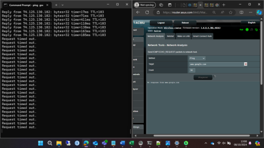

5. Using the network analysis feature from the router, it shows no response from google during the same time that there is no response when pinging via my laptop (have attached a screenshot as well).

I am no networking expert, but I would like to ask some clarifying questions:
1. Is this a network loop? Personally I dont think so since that should affect devices connected to the ethernet as well
2. Could this be a firewall issue? I disabled AiProtection and parental control however the firewall feature is currently still turned on,since I think its a bad idea to disable it, since we would have even less protection as well.
3. I would prefer a hard reset to be my very last option, since we have no saved config files from when the routers were working well (Lesson learned). Any other ideas?
