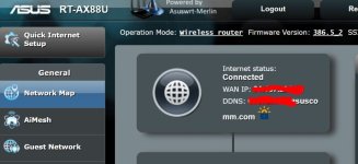

RT-AX88U Merlin Firmware 386.5.2 This has been running for weeks. But today whilst making a small change noticed that in Network Map, the internet status is shown as Disconnected. However, the router is working perfectly well. But the error is niggling. Everything seems fine. I do have another unused router model RT-AC2900. I exported the RT-AX88U settings into the RT-AC2900. I ran that and found it has the exact same problem (internet state disconnected). So, I installed standard Asus firmware 3.0.0.4.386_48260. Low and behold the Internet is shown as connected. See the two attachments. So the problem appears to be with the Merlin firmware 386.5.2
My question is there something that I can do to fix the problem? I do not really want to go through a complete factory reset - reinstall everything to find that the problem still exists. Is there anything else less destructive that I can do to fix this error?

You are describing two different issues. In your OP you said the status showed Disconnected but everything still worked "perfectly well". This is typically caused by a recent upstream change made by Asus and subsequently picked up by Merlin. It can usually be fixed by doing this: https://www.snbforums.com/threads/a...nnection-but-internet-works.78388/post-756752

Thank you very much for the fix, I applied it and the problem is solved. With great relief, because I use some functions of Merlin which made using Asus dd-wrt a difficult option.
