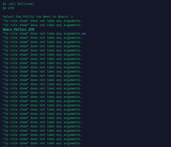

Whenever I do a manual policy query via SSH terminal through the addon's main menu, I always get the following warning many times:
"ip rule show" does not take any arguments.

Dear @Ranger802004, I've had some free time today and did some research to provide you with more details that are very interesting to me at least!
1- The only "ip" binary I have is located at it's normal place. Following are related commands with their output:
ls -g /usr/sbin/ip*
-rwxr-xr-x    1 root        273716 Jul 20 20:38 /usr/sbin/ip
lrwxrwxrwx    1 root            13 Jul 20 20:38 /usr/sbin/ip6tables -> xtables-multi
lrwxrwxrwx    1 root            13 Jul 20 20:38 /usr/sbin/ip6tables-restore -> xtables-multi
lrwxrwxrwx    1 root            13 Jul 20 20:38 /usr/sbin/ip6tables-save -> xtables-multi
-rwxr-xr-x    1 root        111392 Jul 20 20:39 /usr/sbin/ipset
lrwxrwxrwx    1 root            13 Jul 20 20:38 /usr/sbin/iptables -> xtables-multi
lrwxrwxrwx    1 root            13 Jul 20 20:38 /usr/sbin/iptables-restore -> xtables-multi
lrwxrwxrwx    1 root            13 Jul 20 20:38 /usr/sbin/iptables-save -> xtables-multi
ls -g /usr/bin/ip*
lrwxrwxrwx    1 root            17 Jul 20 20:38 /usr/bin/ipcrm -> ../../bin/busybox
lrwxrwxrwx    1 root            17 Jul 20 20:38 /usr/bin/ipcs -> ../../bin/busybox
2- No "ip" binaries availabe inside entware binary directories
ls -g /opt/bin/ip*
ls: /opt/bin/ip*: No such file or directory
ls -g /opt/sbin/ip*
ls: /opt/sbin/ip*: No such file or directory
3- The PATH variable is set correctly when your script starts up, it shows the following in logs:
domain_vpn_routing: Debug - PATH: /sbin:/bin:/usr/sbin:/usr/bin:/opt/bin:/opt/sbin:/bin:/usr/bin:/sbin:/usr/sbin:/home/atr:/mmc/sbin:/mmc/bin:/mmc/usr/sbin:/mmc/usr/bin:/opt/sbin:/opt/bin:/opt/usr/sbin:/opt/usr/bin
4- The version of the only ip utility I have is:
ip -V
ip utility, iproute2-ss150210
5- I even added the following line to my /jffs/configs/profile.add file then rebooted the router, with no luck again:
alias ip=/usr/sbin/ip
I can't think of any other reason why your script is not working as expected on my RT-AC68U. Are there any more debugging steps that you may need to figure what is the problem?

ip -V
This is the problem, this version of the binary doesn't support the same functions as the common found on most routers running ASUS Merlin (iproute2-5.11.0).
