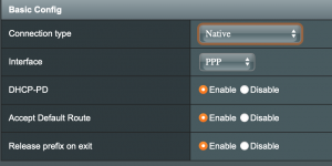

The 1st item (seeing as we are using the same router & firmware) is at the top of your 1st image. For whatever reason, you appear to be missing two records on there: 'Interface' & 'Accept default routes' - I've attached a quick screen grab for reference:
I've previously found, that the value selected via the 'Interface' record is vital to configure IPv6 to suit the config of your own ISP (although pretty sure you'll be able to select / change via ssh if / when needed).
The 'Accept default routes' choice too, but that's of a much lower level of importance. Did you have these two records present in your GUI, prior to you switching over to 386.1_2 ? I did on 384.19.
I think the difference is the fact that your "WAN - Internet Connection" is not the same as I am using. You have a selection using PPP on the IPV6 setup and I do not even have that selection as on my picture of the IPV6 settings. I am using "Automatic IP" and I think you are using "PPTP" for your "WAN Connection Type" but it is possible that your provider provides a different connection type and I am pretty sure that you are not using "Automatic IP". So those other selections are not available on my setup.
Yes, sorry I hadn't gone that far backwards in the chain. I shout have included those details too.
On this specific router, there is no PPPoE support for IPv6, that's why I am using PPP. I believe other (later) Asus routers do now support PPPoE as a WAN mode for both IPv4 and IPv6.
Yes that's almost correct. I'm using PPPoE for "WAN Connection Type" not PPTP although I can and do use VPN too - separately. I use PPPoE despite me having a Static IPv4 address. This is purely because I am using IPv6 too, but, without the router's ability to support PPPoE for IPv6... Otherwise I could successfully use the Static IP "WAN Connection Type" for both IPv4 and IPv6.
I do have a static IPv6 address (of sorts) too, but only static as far as a firm, non-variable LAN IPv6 Prefix is concerned (hence a fixed pool of IPv6 addresses from the router) but, my own WAN IPv6 address can change, after a router re-boot (unlike IPv4) but, it changes only within the relative WAN IPv6 pool itself (if it does). This does NOT affect the LAN IPv6 Prefix and thus the fixed pool of IPv6 addresses provided by the router to change, but the WAN IPv6 address change is enough to make getting DDNS via IPv6 to run properly, a lot more challenging that it otherwise would be...
Moving back to your initial point, yes, there's quite a lot of differences, both visible and knock-on (e.g. IPv6 as you've mentioned) as a result of two different WAN Connection Types: Automatic IP and PPPoE. That means, any chance of us identifying a subtle difference in our same router / same firmware setups as the cause of your IPv6 failures, has now massively diminished, sadly...
