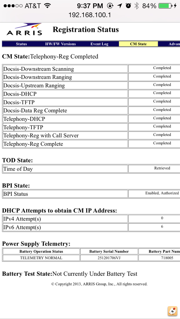

Have you ever looked at the CM tab on your modem (assuming you also have an Arris Docsis 3) I don't know exactly what or how it's counting, but it says I've been issued 6 IPV6 addresses and 0 IPV4? Regardless, both work fine for both DHCP & DNS and the Asus hands out IPV6 to all my devices.
