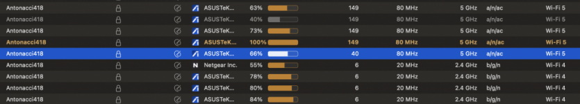

The only one thats on the configured channel 40 is the one coming from the RT-AC5300, All the nodes are using the DWB channel of 149. IDK why this is. They still work though? so i'm just confused.

All my nodes are Ethernet wired except 1. What your seeing is my WiFi scanner. All the nodes are broadcasting on channel 149 which is the dwb channel. If I change the dwb channel the nodes change to broadcasting on that new selected channel & still don’t broadcast on the main 5ghz channel which doesn’t offer 149,153,157,161.

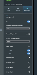

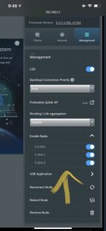

If you go to the iamesh then click on one of the iameshes and then click management -> radios. Is 5ghz-1 turned on?

This is what I see.. I don't see two seprate 5Ghz options. It just says enable radio 2.4ghz & 5ghz.

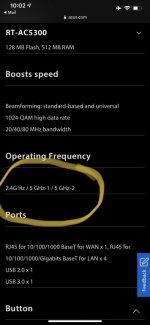

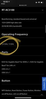

Okay I think I figured it out. So your RT-AC5300 is a triband router which I have myself also and it uses the 5ghz-2 and 5ghz-1 but your RT-AC3100 is only dual band and only uses the higher band for 5ghz. So it’s working as intended I believe. The best way to test it, is setup one of the ac3100 nodes as just a regular AP or Router and see what channels you have available. I bet you only see the higher ones. The lower bands are actually new because they provide less interference And must not have gotten added to the ac3100.
