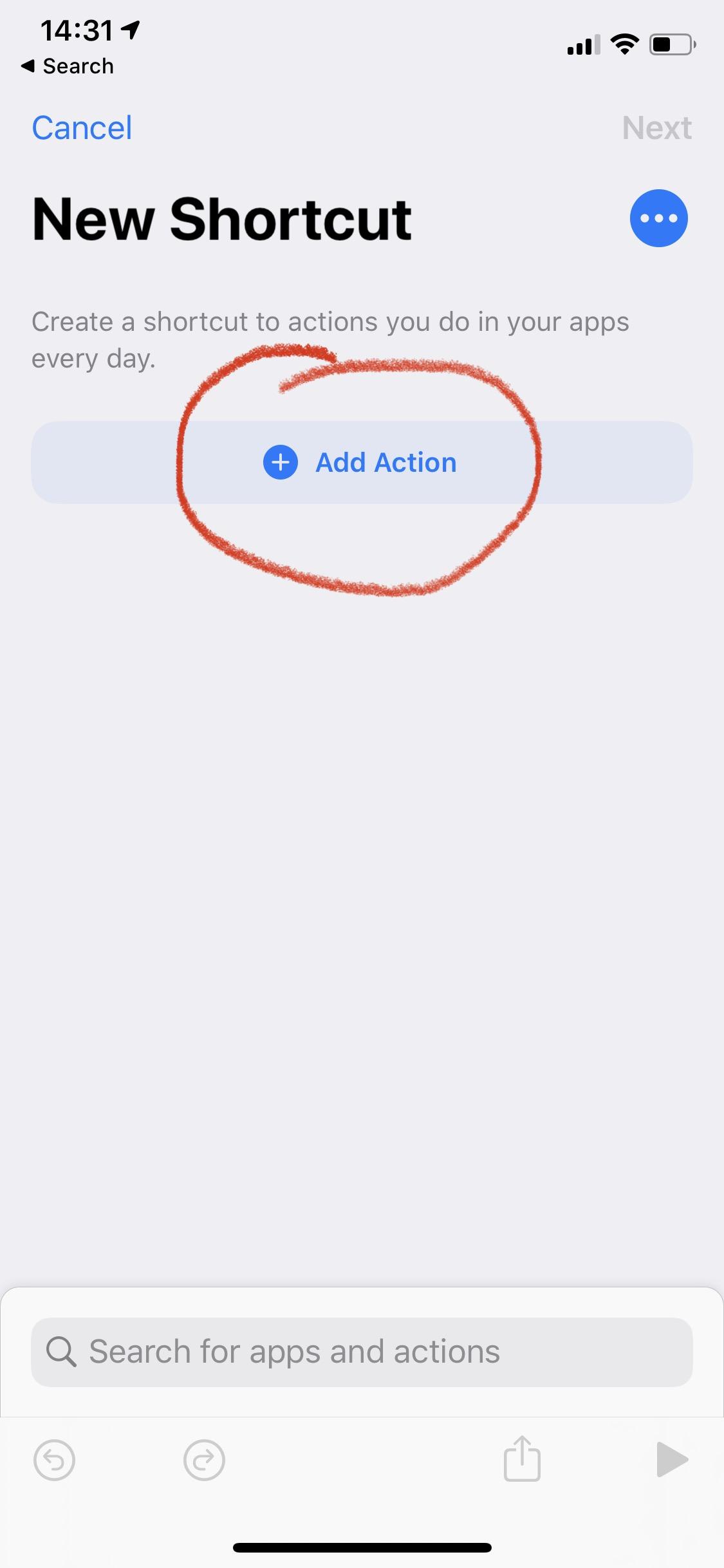

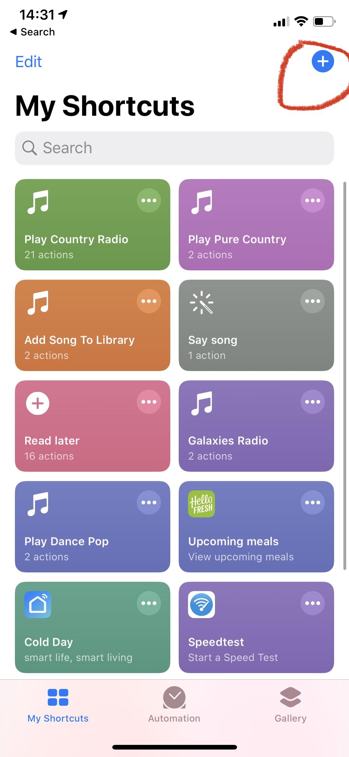

Open Shortcuts
Tap + on top right to create new
Add Action

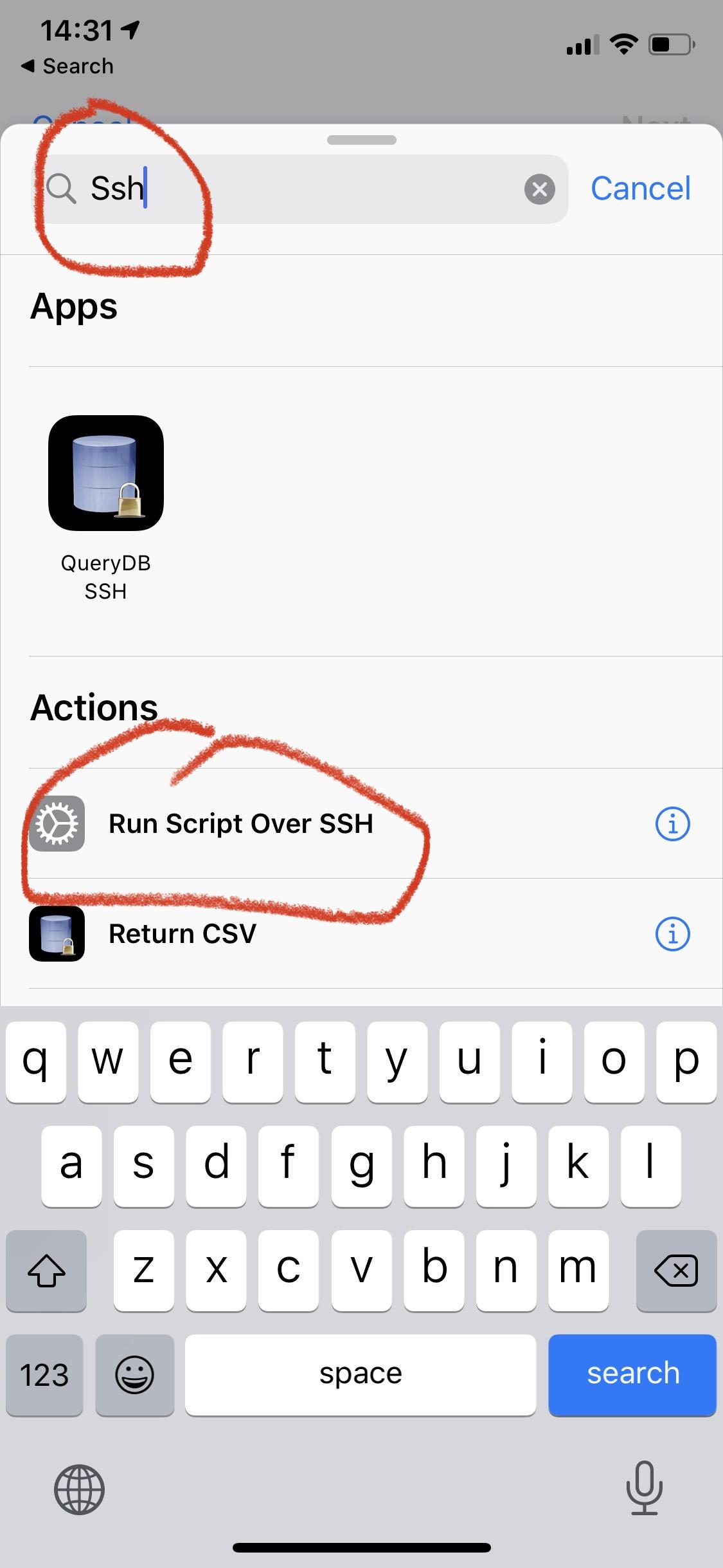

Search “ssh”

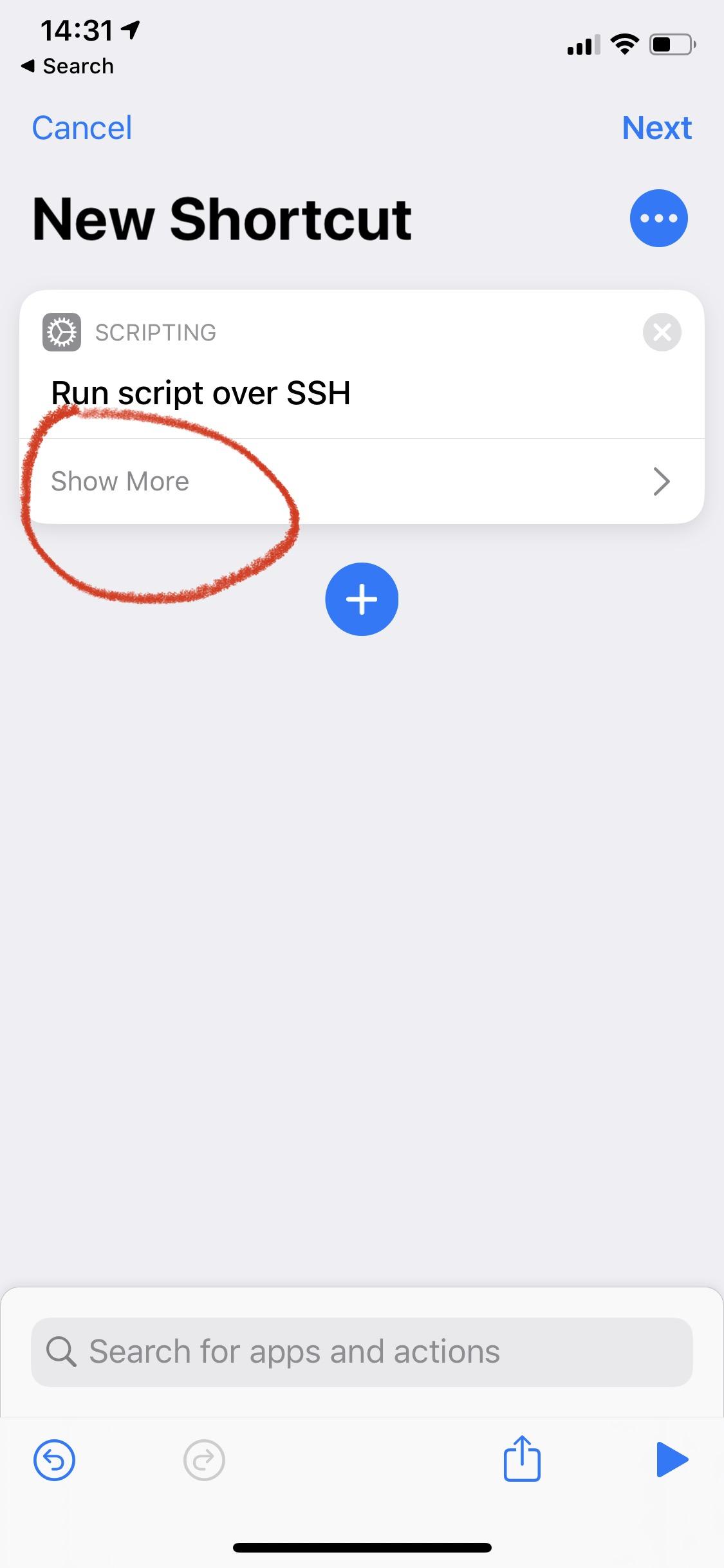

Select Run script over SSH
Show more

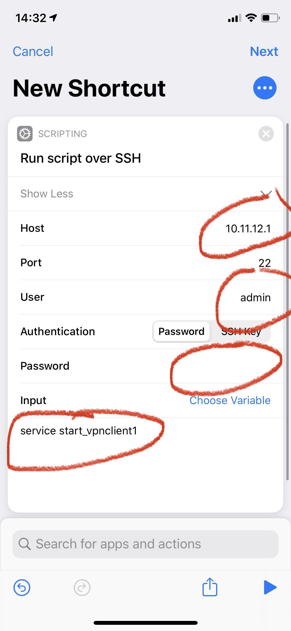

Host=IP of your router
User=admin
Authentication=password
Password=your router password
Script=service start_vpnclient1
Tap > in bottom right to run it and test it works. First run it will warn you it is an “unknown host”, just tap Connect.

Open Shortcuts
Add Action
Search “ssh”
Show more
User=admin
