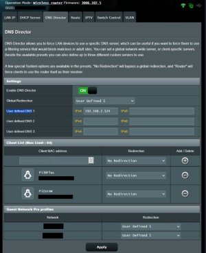

You can configure LAN> DNS Director to perform this step. DNS Director has a section for Guest Network Pro profiles where you can select the Guest Network Pro profile and assign a User defined DNS field to it. You would input the Pi-Hole's IP address into that User defined DNS field on the DNS Director page. There are likely more configuration one may need to do on the DNS Director page depending on one's use case. On the Pi-Hole you will likely need to change the DNS Settings > Interface Setting from Allow only local requests to Respond only on interface so the Pi-Hole correctly accepts DNS requests from the Guest Network Pro profile's IP subnet.
Edit to add: See attached example of how I have my Pi-Hole(s) configured under 3006.102.5 firmware on a RT-AX86U Pro. In my example the Guest Network Pro Profiles (two of them) use the Pi-Hole's IP address that is input into the User defined DNS #1 field.
