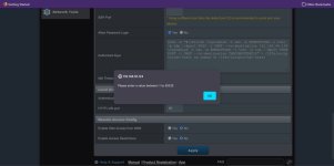

Well i must do something because now it won't let me input port forwarding. How cam the nvram be near full when i just got this router yesterday
Then it's unlikely you've run out of NVRAM space as that router has twice the space compared to the older models.
Why do you think the NVRAM is nearly full? What error message are you seeing?
If you go to Tools - System Information you can see the NVRAM usage.
Please enter a value between 1 to 65535..that's what i am getting when i try to apply port forwarding. According to my searches that happens when the nvram has used up lots of space
Can you post a screenshot showing what you're trying to enter so that we can understand the problem.
here is the picture
it's a script for port forwarding from mullvadvpn..that must be done before i configure port forwarding in the router's interface
That's not how or where you do port forwarding or create scripts. Where did you get that information from?
That's where i did it last time and it worked for my RT-AC86U..That's part of mullvadvpn instructions for their port forwarding
