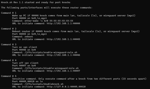

Once started, knock.sh will display the current configuration with each command shown with the URL you can use to execute it. Here is an example screen shot:

So, for example, with a configuration file with this command line:
#Comments and blank lines allowed
#Port_Num  Interface(s)    Commands
#The comment before each command will be shown when displaying the configuration
#This comment can describe the following command which here is ether-wake command to a specific PC
44444      br0    ether-wake -i br0 xx:xx:xx:xx:xx:xx
Users can now execute the ether-wake command on a specific PC by sending a port knock from main lan interface by browsing to the following url: http://192.168.50.1:44444
Example Use Cases​
  1. Allow a user on local LAN, using the wireguard server, or the Tailscale server to wake up a specific PC. Put the following line in the config file:
    44444 br0,lo,wgs1 ether-wake -i br0 xx:xx:xx:xx:xx:xx
  2. Allow that same user to reboot router:
    44445 br0,lo,wgs1 reboot
  3. Allow a user on the local LAN to run a custom script that enables something (e.g. a VPN Director rule):
    44446 br0 /jffs/scripts/enable-example.sh
  4. Allow same user to run a complementary disable script:
    44447 br0 /jffs/scripts/disable-example.sh
  5. (New for v1.2) Sensitive command. Only execute command after a knock from two different ports (15 seconds apart):
    44449,44410 br0 /jffs/scripts/doubleknock.sh

Knock.sh updated to version 1.1!
Updates include :
  1. Added better reporting of current configuration including URL example based on interface and port (see new screen shot in the Install section of the first post) [Partially addressing @jksmurf request]
  2. Documented "Update" function which will download and install the latest version. If you already have Knock.sh installed run the following command to update to v1.1:

Knock.sh updated to version 1.2!
Update includes a new built-in "double knock" functionality for sensitive commands (partially addressing @Reef2009 's request). If the configuration line has two port numbers listed (separated by a comma), the command will only be executed if a knock is received from each port one at a time (separated by 15 seconds)
To update to the latest version, enter this command:
Bash:
/jffs/scripts/knock.sh -update
Rung
Bash:
Rung
Nice I'll test when I'm back next weekend 😃
Try this to see if it works for you. First create this test script called doubleknock.sh in /jffs/scripts/:
Bash:
#!/bin/sh
logger -t "doubleknock.sh" "Sensitive command executed by double knock"
Make it executable:
Bash:
chmod 755 /jffs/scripts/doubleknock.sh
Add this to your /jffs/addons/knock.d/knock.cfg file:
#Sensitive command. Only execute command after a knock from two different ports (15 seconds apart)
44449,44410 lo /jffs/scripts/doubleknock.sh
Restart knock.sh:
Bash:
/jffs/scripts/knock.sh -restart
Then run this test command:
Bash:
curl 127.0.0.1:44449; sleep 15; curl 127.0.0.1:44410
Then check the log file to see if it command was executed.
