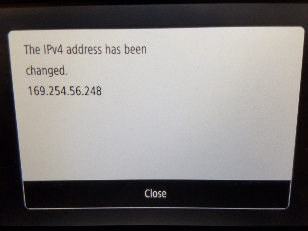

My home LAN printer (Canon Color imageCLASS MF644Cdw) at 192.168.x.x for a few weeks suddenly changed IP v4 address to 169.254.56.248 !
I turned it off. Anybody know how this might have happened and whose IP that might be?

I was beginning to think someone got in via its Google Cloud Printer registration..

It was bound to a fixed local IP address via its MAC addeess. I had upgraded router firmware, rebooted, and added an AiMesh node to the network. The printer must have gotten confused and connected somewhere else.Might also want to give your printer a static IP then you won't get those messages
Not the same thing as configuring a static IP. Good practice for devices like printers, switches, etc as the can still work as expected if there is a DHCP issue or other funky network problems. Clearly, there was a DHCP resolution issue in your network when the fallback IP was used by your printer. Just saying this can easily be avoided in the future.It was bound to a fixed local IP address via its MAC addeess.
Let me take a look at assigning the printer a static IP address. That may be somewhere in the printer settings/config?
I've always manually assigned specific local IP addresses to selected devices in my router settings, via the device's MAC address.
But that would still not eliminate the need to bind that IP address to the device MAC address, right?
e.g. what if there was a power outage, when power came back up, some other device that came onto the home network before the printer got DHCP-assigned the static IP the printer was set to use?
Sent using Tapatalk
A good plan, as long as DHCP is functioning. I do both. I set a static IP on the device and configure a set IP in the DHCP server just in case.I've always manually assigned specific local IP addresses to selected devices in my router settings, via the device's MAC address.
