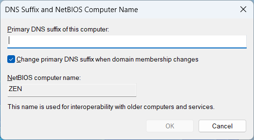

You see this error because you have specified a Primary DNS Suffix for your PC's computer name. You should leave this blank so that your PC will obtain the DNS suffix from the router using DHCP option 15 instead of trying to use option 81.
Thanks, that solved it!
