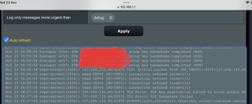

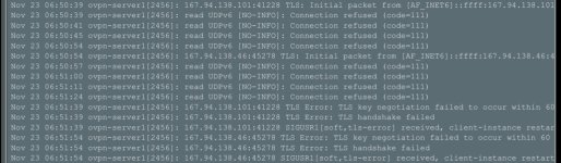

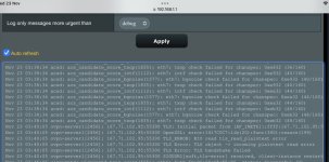

As title really, RT-AX86U Merlin 388.1 Beta 2. See log extracts showing OpenVPN Server refusals, and a SIGUSR1 entry.
I am fairly certain it wasn’t me because I was either sleeping or hadn’t accessed the server in the last week at all.
Is this a normal log or should I be concerned? Web Access from WAN is not enabled. No ports forwarded. There are 4 instances over the last 2 days it seems?
I am no router / network expert but if you can explain what I need to do to check I can follow instructions pretty well.

That's normal port scanning. For example, the 167.x.x.x addresses are Censys. If you haven't already done so change your VPN server port to something that isn't the default (1194), and isn't obvious (e.g. 8000). That will reduce the amount of "noise" in the log.
This is not an issue specifically with the Beta release.
