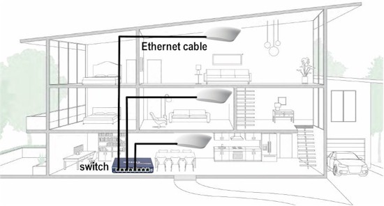

So I'm thinking of the following below but I won't be able to do any tests before house is complete. Mid October.
For 5Ghz
UNII-3 = Channel 161 on top floor
UNII-1 = Channel 36 on the main floor
UNII-2 = Channel 64 in the basement
UNII-2 Extended = Channel 124 in the garage
For 2.4Ghz
Channel 11 on the top foor
Channel 1 on the main floor
Channel 6 in the basement
2.4Ghz off in garage
