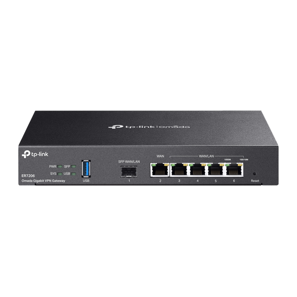

I would add this Gateway for up to Gigabit ISP:

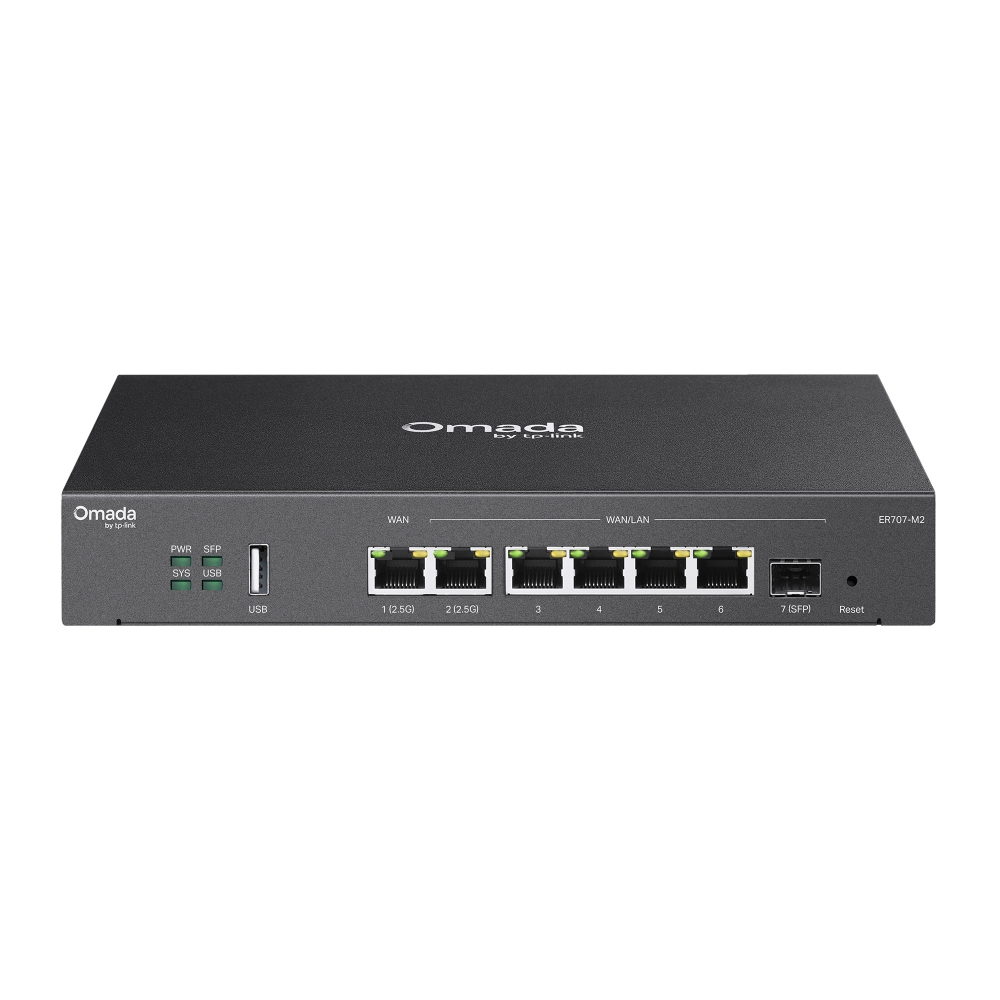

Or this one for >Gigabit ISP with two links to every Netgear switch for >Gigabit aggregate throughput:
