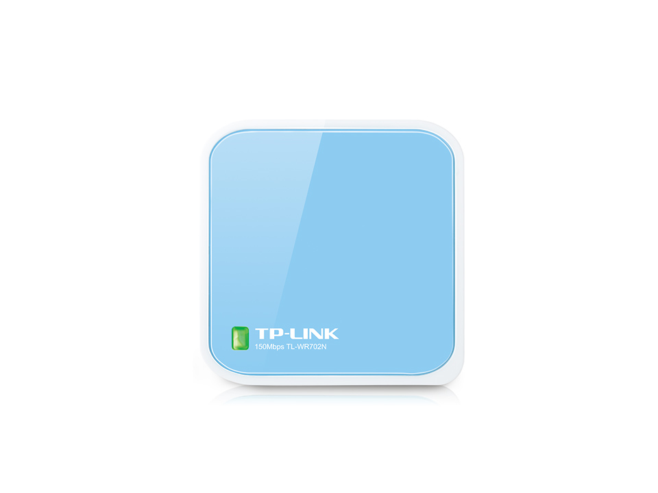

How about this (don't know whether it has an AP mode):
I wasn't suggesting removing an antenna, just buying a device that only has one antenna. If such a thing exists.
Sorry, misunderstood you. I've been looking, but even cheapo travel routers are two stream.
Near as I can tell, it's two stream.
