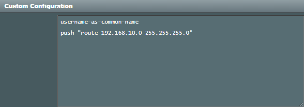

My custom configuration is: (15-5-2015 15-41-13.png)
username-as-common-name
push "route 192.168.10.0 255.255.255.0"

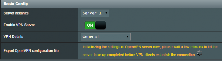

Adding these options to the custom configuration in advanced setting for VPN
script-security 2
client-connect /jffs/scripts/gmail-notification openvpn-event
results in: (15-5-2015 15-43-06.png)
Initialinzing the settings of OpenVPN server now, please wait a few minutes to let the server to setup completed before VPN clients establish the connection.
which be running for ever it seems, when changing it back all working as normal.
What am I doing wrong?
script-security 2

If you have a /jffs/scripts/openvpn-event script that has syntax errors then this will happen, but I suspect as you appear to be passing the name of a script to run called openvpn-event it doesn't exist! :eek:
I suggest you remove 'openvpn-event' from the panel.
Also check the log to see why the server is failing if this is not the case.
