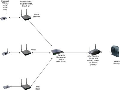

Right, just moving a step forward with this and I found a nice site to make pretty pictures, no affiliation.
So it shows the current situation (with only 3 Mesh Nodes but there are actually Ethernet cables for 5).
I cannot change the cabling, it's my folks place and it is all built in to the walls.
Each Node should provide Primary, Guest and IoT Wifi, with the current wired backhaul i.e. no difference between rooms. I think this part is OK, and lets assume the Main Router (assuming ASUS) has GNP and the Nodes are all 3006 FW capable too i.e. sufficient Wifi interfaces will propagate to the Nodes.
If I wanted to now add WIRED (more reliable, less 2.4GHz interference) ESP32s to the IoT Network (ONLY) what would be the minimum hardware (ESP32s aside) to do this?
I assume that for the ESP32 devices, even if you give them a Static IP burnt into their FW, are not clever enough to recognise tagged packets, is that correct?
So, again, assuming I would like the ESP32s to appear in the IoT Network:
  1. Can this be done with the Router Alone; I am pretty sure it cannot; so
  2. Can it be done with just a Managed Switch (replacing the unmanaged one), assuming that the cable from 3 separate ports goes to each Mesh Node and the ESP32s are plugged in to teh Nodes LAN Ports (Again I am pretty sure this cannot work, but less sure that (1); or
  3. Will I have to add an additional managed switch at each room location, with one port feeding the AIMesh Node and the other the ESP32 Ethernet Device (** i.e. the ESP32 NOT plugged in to the Mesh Node, but rather a small managed switch)? If this is the case can I forgo having to replace the current larger (8 port) unmanaged switch with a managed switch or is that ALSO required. If yes, why would this be the case please?

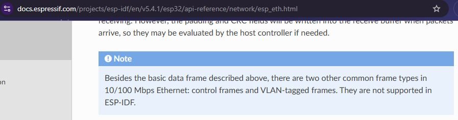

Way over my head, but it seems like it might be possible.
If I could somehow configure the Ethernet-connected ESP32 to be VLAN-aware, then that would be the ultimate solution here. Like I said, have not seen anything yet by way of a line in a HA yaml which will effect, this, but there's hope...

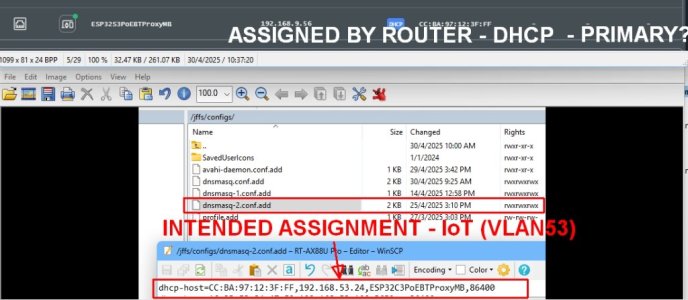

I’m not 100% sure I follow, but what led me to ask the question is that I have Primary (192.168.9.xxx) and two GNP VLANs, Guest (VLAN52) and an IoT (VLAN53).
I tried to manually assign an IP to the ESP32-Eth device in the Router (192.168.53.xxx) but when I (just for starters) attached it to my Node (or even my Router), without going through a managed switch (or setting a VLAN on the Router Port) I wasn’t surprised to see that it was assigned an IP in the primary subnet 192.168.9.59.
I haven’t tried it but have been told by the HA forum it will not work to force an IP address in the ESP2 FW (I.e. static IP), hence the query here.

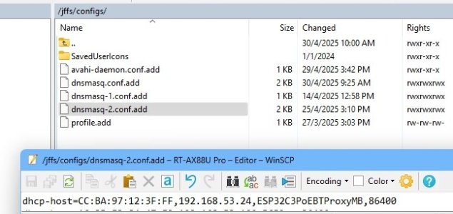

Yes Merlin certainly does that and does it especially well with an Addon. I use YazDHCP for the Primary network, even wrote a little Excel spreadsheet to make the custom_clients list to upload the Custom Client List and make Custom Icons.
I use dnsmaq.conf.add (actually dnsmaq-1.conf.add and dnsmaq-1.conf.add) for my Guest and IoT Networks. The Custom Client List file takes care of the Icons and names for those as well.
In this instance though, despite assgning the ESP32-Eth Device in the IoT VLAN, when plugged in to the Ethernet (due to me not assigning a VLAN on the Router Ethernet Port / or using a managed switch), the Router just assigns a DHCP Address on the Primary Network. I believe this is expected behaviour.
