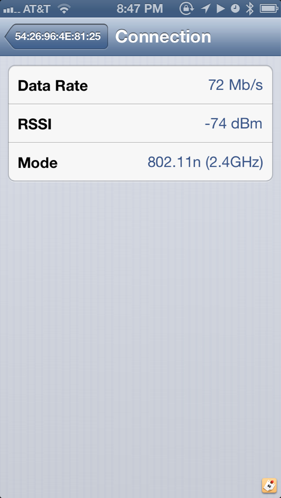

Also the iOS Airport Utility is to use on your iOS device for troubleshooting & Apple branded AP setup/placement, it gives you live RSSI to any connected device (in this screenshot I'm checking my phone's wifi from the AP's perspective).
I believe it's possible to do a hack on unjailbroken phones to give raw RSSI #s the menu bar (similar to field test mode for cell signal), but this is faster & easier for me.
The Asus h/w also gives you a view of connected wifi devices & their connected speeds, but it's #s are usually a bit stale.
