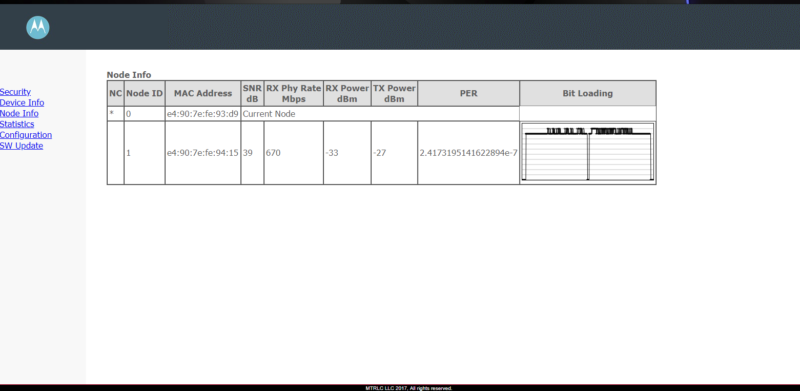

Hello,
I recently got a MoCA 2.0 Bonded System, but for $120 and 'Gigabit' speeds advertised in a little disappointed. I had to run a new ethernet cable to my attic and when these die I'm just going to run a standard cat5e cable up to the wall. iPerf3 speed tests show ~790mbps speed for a completely dedicated coax cable. Are there any settings I can change in the configuration to make it go a little faster?
note: there is no tv service or any services running, I just ran a coax cable like an ethernet cable. nothing else
