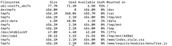

Next time it happens, can you check if there are multiple entries for menuTreee in df -h please?
Is this something I could check too? Is that command done in SSH?
yes and yes!
Did a reboot just now and left it 15 mins before logging in to the web gui to find only Modmon has loaded this time.
Was it just the df -h command in SSH? Did that and the below screenshot is what it showed up.
