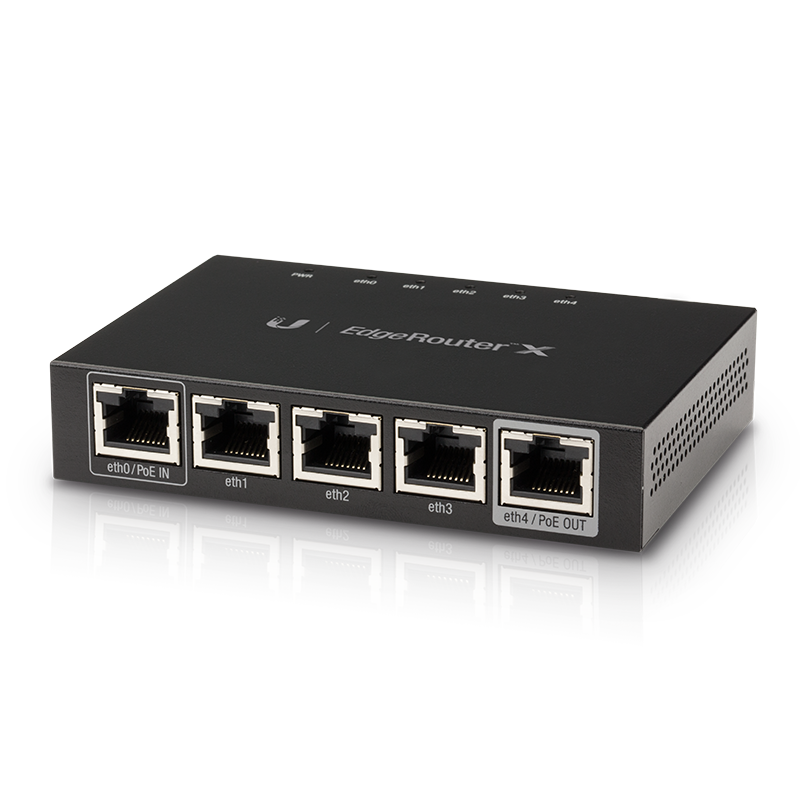

Am I understanding this correctly? I could get this $50 EdgeMax router and configure a few different ways:
1. ER-X + nanoHD = $229 with AC wifi
2. ER-X + AmpliFi Alien (set to bridge mode) = $429 with AX wifi
3. ER-X + Aruba Instant On AP22 = $210 with AX wifi
What am I missing? Seems too good to be true. The Alien would be the priciest option but allow to run without the ER-X initially until we move to our "permanent" home and setup the home network I want.
EdgeRouter X
