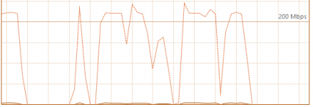

@ColinTaylor Found out this issue is not limited to video playback, turned out when I stop all torrents & just uploading a 7gb file to google drive & directly connected to primary dlink router via 5g usb wifi adapter I still face similar issue where upload speed continuously varies from 220mbps to 0 in windows task manager performance tab stats.

So I tested by directly connecting my pc to primary dlink router via ethernet & even then I get similar result of "speed drop spikes" every few second. This is what the transfer speed looks like while uploading a 4gb file with max(& expected) speed of around 220mbps(see attached file). Is this normal or does this mean my dlink router simply cannot handle 100mbps+ speeds despite being a gigabit router with 128mb ram & ~800MHz dual core mediatek processor in which case is it the hardware or the software which is the reason behind such poor performance.
