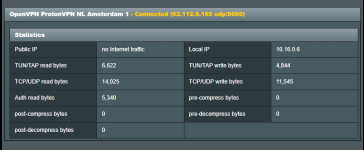

Guys, the router is connected to ProtonVPN however, on the computer connected to the router when I point the browser to whatismyip.com and .speedtest.net it shows my real location IP and ISP instead of the ProtonVPN server's IP.
I have done everything but at Public, it keeps giving unknown see here:
Connected (Local: 10.96.0.3 - Public: unknown)
Also in the log, I see this:
NOTE: setsockopt TCP_NODELAY=1 failed
What I'm doing wrong?
It seems I found the issue. If you have 2 different VPN clients you need to close the one you use in order to use the other one (new one). This was the case with me.
No issues here. I have 5 concurrent ones running with various devices connected/routed via VPNDirector

No even slightest idea how to walk it around? Because the Proton VPN support gives up on this one. Not the first year.
Could it be DNS assignment problem? I put it manually to 'WAN DNS Setting' in 'WAN - Internet Connection'. 1.ISP-DNS, 2.Google-DNS!
