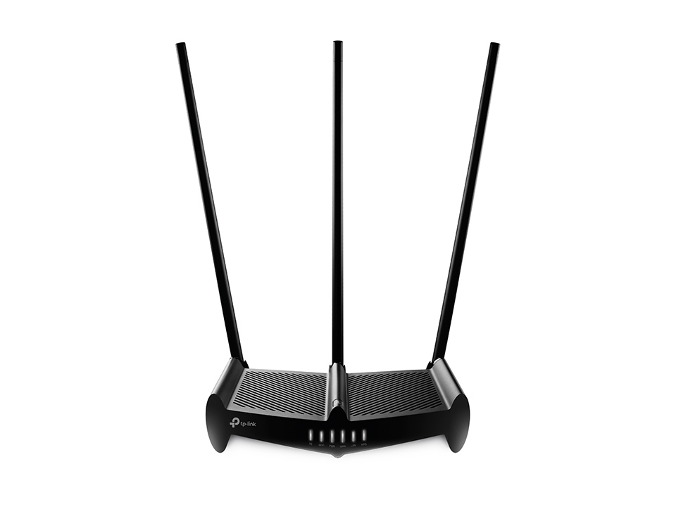

I have a small business, whereby I have to setup 60 wired computers and 20 wireless devices.
Should I have one router with multiple wired and wireless switches or should I setup multiple routers?
Would that one router connected to multiple switches be able to take "load" of 80 devices?
What is maximum number of wireless devices a generic consumer grade router handle? For 20 wireless devices located in 400 sq foot area, would this router take care of it.

Are these concurrent users/devices using this proposed solution? The 941 will be easily overrun by more than 15 wireless clients.

You should not be even considering 802.11n at this point. AC/Wi-Fi 5 at minimum.

I think @hussain is confusing wireless Access Point with a router since most consumer wifi access points are called "wireless routers".

For your use case, you would need only one router for your internet entry point and then as many access points as you will require to cover the physical space needed. Different access points have different number of client limit but with only 20 client, almost any access point will do. The TP link you listed is however as others mentioned, very old and slow.
