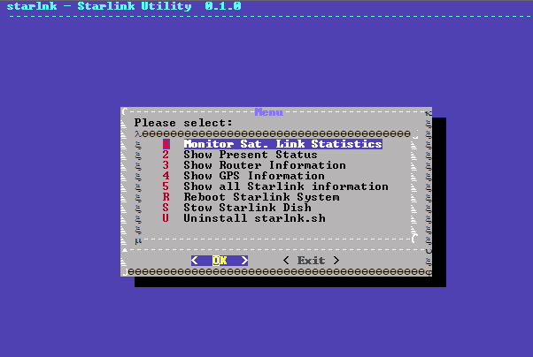

When started without a command line argument, starlnk will display (using the fine Linux dialog utility) its main menu
You can use the keyboard arrow keys or type the menu item directly.

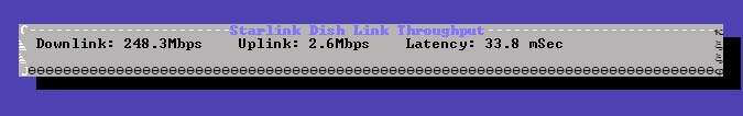

The first selection, "Monitor Sat. Link Statistics" will show a screen with the present uplink/downlink speeds and latency. It will refresh every 3 seconds until you press the Enter key. It looks like this:
Keep in mind, this is the Satellite to dish rates and NOT the actual download or upload speeds. For those, use something like spdMerlin.

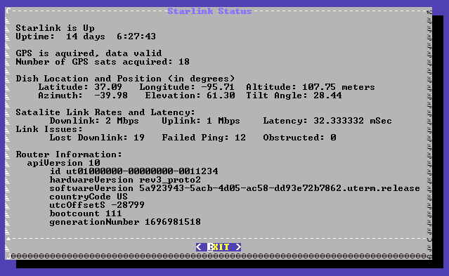

Another example of one of the screens (Show Present Status) shows various details about the dish and router:
Keep in mind, this is the Satellite to dish rates and NOT the actual download or upload speeds. For those, use somehting like spdMerlin.
