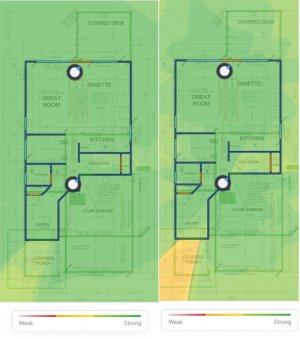

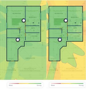

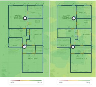

If your house is really this Wi-Fi transparent perhaps one AP per floor is enough. Not in the middle though and one on top of the other. Each one closer to the opposite end of the house. Basement and 3rd level on one side, 2nd level on the other. Play with the tool.
Is there a difference between the Ultra and the Flex 2.5 PoE that is meaningful from a network features perspective? The powering difference options and the SFP doesn't really mean much to me - at least I don't think. Unless that would make a difference in terms of the connection between the gateway and the switch? If I don't care about 10Gbit, then I could simply use a regular port to link the gateway and the switch. In that case, the Ultra w/ the 210W adapter seems the better choice compared to the Flex 2.5 PoE come a cost perspective. Am I reading that right?
The issue with the tool is that I don't know vertical coverages. I would be fine purchasing 4 of the U7-Lit units and placing them as proposed in the second heat map layouts I attached. I think that might be a good place to start and then later on, if the basement is problematic, I could always add a AC powered mesh unit, which I suppose would be the U6-Mesh because I won't have run any CAT6. I wouldn't want it just hanging from the ceiling.
i hope the washer and dryer and/or furnace are not in the utility room. The motors and starting relays are good tests of shielding of electronics and cables. They emit a burst of white noise ( all frequencies) every time they start.

Have a look at the Azimuth plot for the AP to see the vertical radiation profile if available. It also should give you an idea of the reverse side radiation profile so you get a feel for possible overlap above (ceiling mount) and behind (wall mount).
You can at least have CAT 6 run in the basement to a ceiling box and cover it with a round flat plate if you are sheetrocking the basement ceiling or just a regular box blank plate.
I don’t really understand how to read the graphs on the Ubiquiti site. Good point about just running the wires to a box with a cover! Thanks man.
I have to pick spots on Tuesday so I think regardless I will run wire to all the spots indicated on the second layout so that if I need all the APs, I have spots for them.
