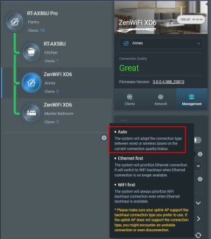

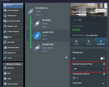

Sorry, was not as clear as I could have been, I should have said I set the Backhaul Priority to AUTO (which chooses dynamically between Ethernet or Wifi).

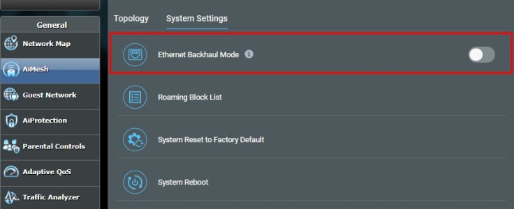

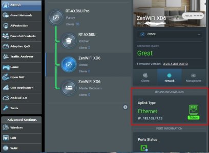

I left the Ethernet Backhaul Mode switch at default, which for me, was OFF, but the Backhaul connects via Ethernet anwyay.
Hopefully that's clearer, but the point was more that if you have Ethernet backhaul connected, it will connect via Ethernet if that's the best mode, you don't have to force it do so and my own experience was forcing it using that switch did not work as well.

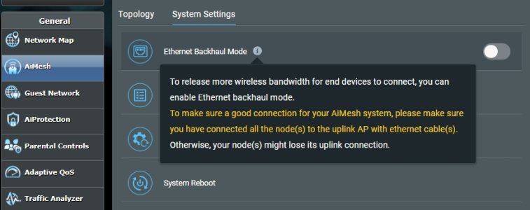

My reading of the EBM Switch is more that it frees up Wireless bandwidth, as it does not reserve Wireless bandwidth.
i.e. in case it has to use it, or drop from Ethernet to Wireless, in case Ethernet goes down.
