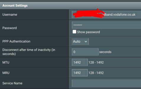

On my BE88U with 3008.102.5 firmware, it is not possible to set Custom MTU settings on the tab WAN/special ISP requirements
My ISP requiers a MTU of 1500. I have tried Chrome Edge and Safari browsers and cleared browser settings, but the problem persists.

Strange. The settings have moved about but MTU is definitely there.
True, but that only accepts MTU up to 1492, i need 1500. On the previous merlin it used to be an option on thay page under 'isp specific', but now that option is gone
Is this really a problem? There were two places to enter the MTU. One only appeared under Account Settings when you were using PPPoE (e.g. 1492). The other was when using Automatic IP or Static IP in Special Requirement from ISP. The latter defaults to 1500, so unless you're looking to lower that number you don't need to do anything.
What show: nvram show | grep wan[01]_mtu
The problem is that i don't have that option under 'special requirements'
