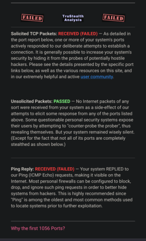

I used the shields up website to check my network for vulnerabilities and I added the result as an attachment to this post. I understand there are settings to mitigate ping reply on Asus Merlin but what about "Solicited TCP Packets"?
When I run the ShieldsUP! scan, the first port 0/nil sometimes 'fails', sometimes does not... I've been ignoring it.

Don't use that website. It's broken and provide invalid recommendations.

Your router's internet facing firewall is what is tested when using sites like https://www.grc.com and their ShieldsUP port scanner. That site can (and does) sometimes report incorrect information on the port status. And the recommendations if provides is considered dubious by some.
