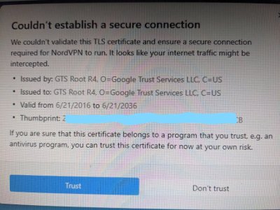

In all the years having a NordVPN subscription (4+ years) have never seen such a pop up message before.
1) Using NordVPN -- it's been active for several days. just leave my computer on 24/7.
2) Using Firefox browser at https://armory.worldofwarships.com/ for the prior 2 hours or so.
3) Had several tabs open (in that Firefox browser) including a youtube.com, and two voice.google.com sessions.
4) Was launching games from the World of Warships game launcher for the prior hour or so.
Any idea(s)?

I am using the app. NordVPN v. 7.8.4.0
The app does show GREEN i.e. connected. When I go to dnsleaktest.com it does show an ip address that is not my own.
I did block out the thumbprint (dunno if that was really necessary to do that--maybe better to show it?) will try and google the thumbprint see what shows up.
ADD: after a google search did come across this:
It's a SHA-1 fingerprint. hummmm, I seem to recall that SHA-1 was being deprecated?
SHA-1 Fingerprint : 2a1d6027d94ab10a1c4d915ccd33a0cb3e2d54cb
Just don't understand why the NordVPN message just popped up out of nowhere. I wasn't doing anything out of the ordinary.

Maybe just a random oddity like you said. I opted for the [Don't Trust] command button and everything seemed to still be working ok/normally. I was on my Windows 10 desktop.

Saw that message today again on my computer from NordVPN also referring to the same SHA-1 fingerprint/thumbprint from google.
Like you are referring to above, maybe google is removing/installing certificates and NordVPN is just notifying/warning me that some certificates have/are being changed.
