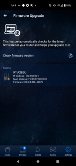

I'm out of state at a wedding right now and through Sunday, but here's a screenshot showing the firmware version the router is on. I opted for remote access during setup, so i can view all the settings in the app from here. I don't mess around with the betas, so this is the latest stable version. I did not factory reset after upgrading firmware. Never heard of doing that before.
I haven't touched any settings in the GUI - including QoS. Nothing has been changed from default, and QoS is off by default (just confirmed).
Interestingly the Verizon tech's usb-c to Ethernet dongle is still showing up as an active wired device in the devices list. No data usage is registering, and he definitely didn't leave it plugged in! Maybe i should try a factory reset after all once i get home, because that's really odd behavior.
