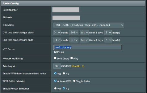

While updating the firmware on my RT-AX86U Pro, I saw my NTP server was set to north-america.pool.ntp.org,
Not sure what firmware you updated from, or if you previously changed the NTP server, but when I updated to 3.0.0.6.102_37421 I performed a hard factory reset. Post hard factory reset my NTP server on a RT-AX86U Pro was set to pool.ntp.org.

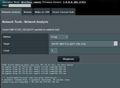

Edit to add: Also, I am getting a ping response from north-america.pool.ntp.org on a Windows 11 PC:
And a north-america.pool.ntp.org ping response using the router's network tools:

I tried north-america.pool.ntp.org again and got a response this time (faster than from 0.*), but I tried again like 1 minute later and 'request timed out' again. I think I'll abandon it if it isn't going to be reliable. Even 0. failed me. So maybe ntp.org is just not reliable.
There's no obligation for an NTP server to respond to pings, although they usually do.
Remember that a lot of the servers in the "pool" are run by hobbyists on their home equipment. I've written here in the past that I've found ntp.org servers unreliable. I've since switched to time.google.com and time.windows.com.
