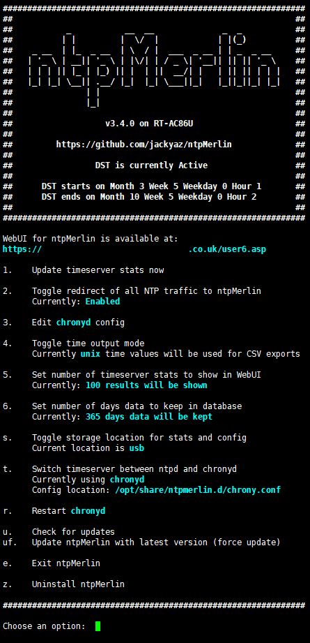

To launch the ntpMerlin menu after installation, use:
ntpmerlin
If this does not work, you will need to use the full path:
/jffs/scripts/ntpmerlin

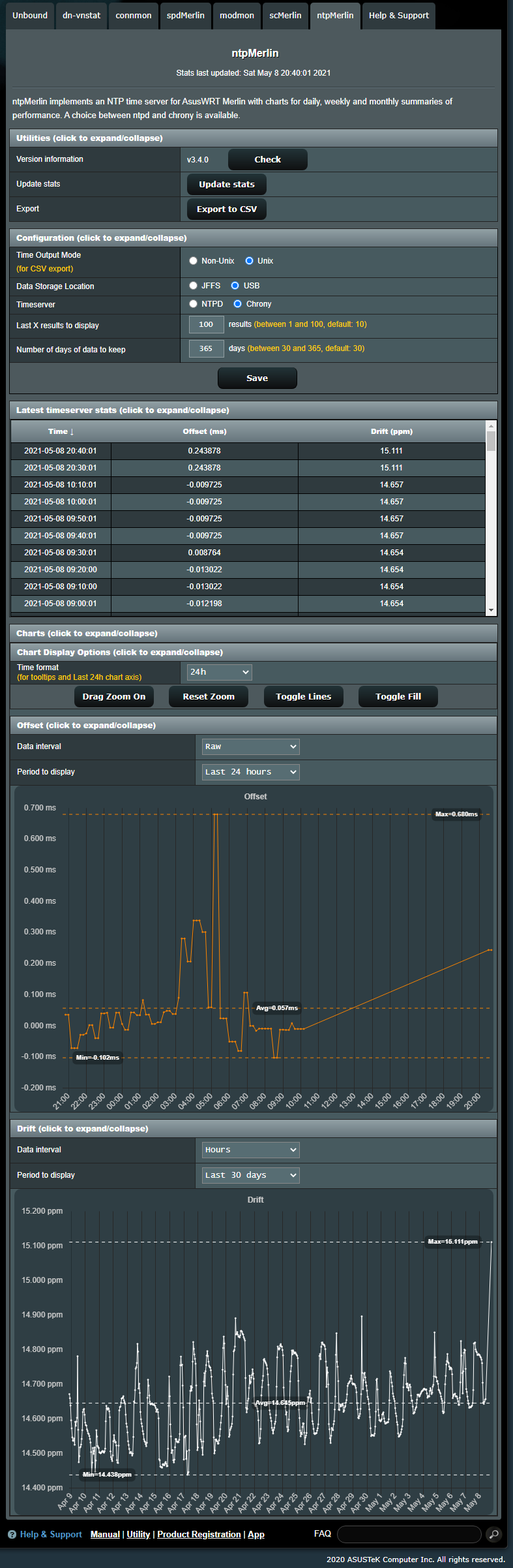

So, I've a question -
is it just me or does everyone else's jitter and drift charts look exactly the same? Jitter and drift are graphing the same dataset, albeit with their respective units. This isn't correct, is it?

I have made some changes on the develop branch
ntpmerlin develop
Jitter has been removed from the WebUI as on further reading I don't feel it's a useful metric. It is still captured and available for users to query in the database or review in the CSV export file.
It looks like an issue crept in a while ago with data being fed into the wrong columns, which I have now corrected. This means Frequency AKA drift will look a bit different, but should be a fairly straight line.
EDIT: moving back to stable from develop will mean database columns will be incorrect and graphs will look weird!
